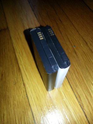

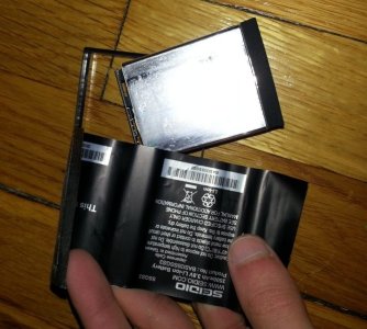

I purchased this battery a couple weeks ago to see what the deal is, because it's double the price of most other batteries. What I found was surprising to say the least.
The first picture shows that there is a large portion of the battery filled with foam, instead of battery. The second one shows that on the outside, it is the same physical size as another extended battery. I used a micrometer to measure both the batteries, and the Hyperion battery is 10.90mm thick, and the Seidio battery is 10.60mm thick.

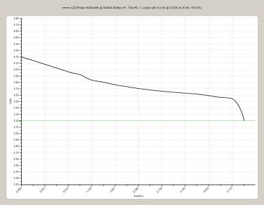

These are my testing results for the ezopower battery and the seidio battery:
It's rated for 4200mAh, but with a 500mA load, delivers 4350mAh.

I measured the Seidio battery and the Hyperion batteries just now, and to my surprise, one of the Hyperion extended batteries measures slightly thicker than the other - so one is exactly the same dimensions as the Seidio battery, and one is slightly thicker (10.6mm vs 10.9mm) This probably has to do with the wrapping the batteries use - the Hyperion batteries use a heavy paper/tapeish wrapping, and the Seidio battery uses a foil type.
