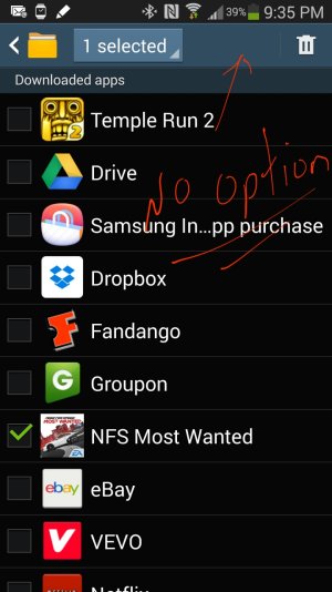

I tried what you suggested however, it looks like I don't have a "share" option in my apps. My GN3 isn't rooted this might be the problem?
It might be because you're not rooted...I get the "share" option from more than one of my file manager apps. Hopefully a few users here will try it out so that we can narrow down the exact process.
