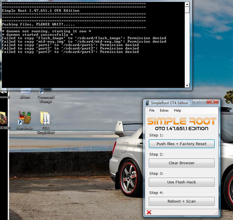

i tried the "simple root" process and got this
Tehman:
I got these errors when the phone wasn't set for charge only when USB was connected. Make sure this is the case.
Settings / Connect to PC
Set default to Charge Only.
The Ask Me option can be checked or unchecked... if checked you'll need to confirm the selection when it is attached.
Also make sure you have USB debugging on...
Settings / Applications / Development
USB debugging should be checked.
It should be smooth sailing from then on.
Tehman:
i've had it set as "Disk Drive"...guess that's my problem lol...lets try again
EDIT: ok it's all working now...in the middle of updating...thanks you guys for the help...this is so much different than a blackberry lol
