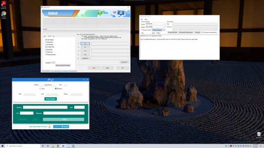

Ok my apologies I am lost. Downloaded all 3 apps
My model in SM-N976V
Tried on Samfirm if gave me error
Frija do not know CSC..???
I am sorry but you are going to have to draw it in crayon and hold my hand for this. I have rooted my old androids but that was 10 years ago and I don't really remeber any of this suff :-(

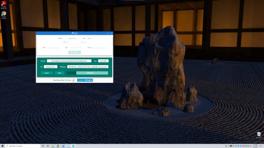

Downloading firmware for U model (no firmware for V). Google'd the At&t model its U. trying this...
