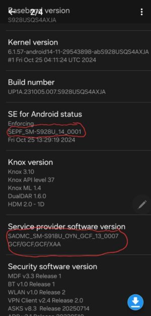

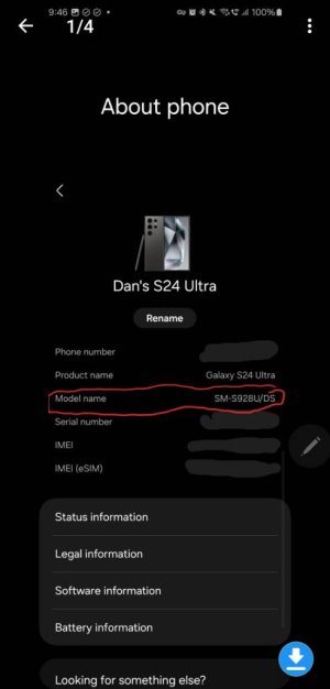

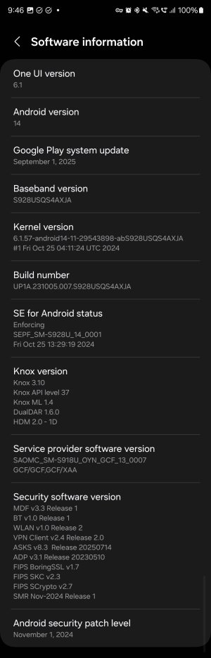

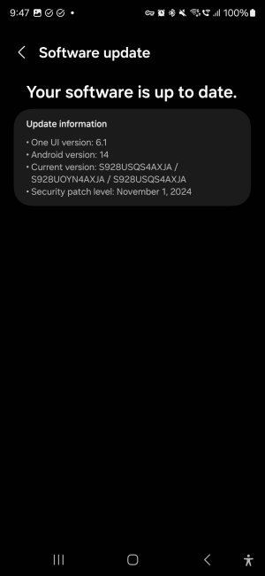

Hi guys, I think I have the same issue. I'm in Australia and purchased a device from an "Australian" company who shipped direct from hong kong, here's my info screens:

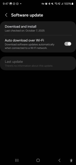

I got a notification a few days ago about a OneUI update, but I was in an area with terrible service so I waited to do it. Today the notification is gone, the Software Update screen says "Download and Install" but when I tap that it thinks for a second then says I'm up to date....
The retailer has been extremely challenging to deal with so I'm just going to try and fix it myself.
I found this thread a few months ago and figured I was going to flash different firmware. I'm comfortable with that if needed, but I see the option to just change the CSC as well and I'm not sure what to do. This is a $1700 device and I use it to generate income, so I just want to be sure I'm taking the right path before I go ahead.

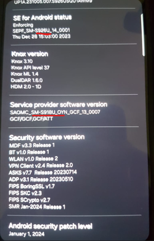

You have 2 different versions on your device, did you flash the s23 to your s24 using CSC? This will never get updates .
You are using a US version overseas?
Look at the screenshot I'll point out in your screenshot in red circle which is not supposed to be unless someone flashed with a different CSC

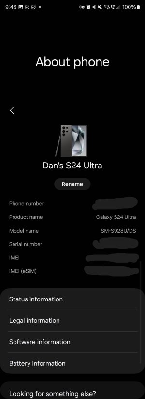

The model number with DS at the end the US version never had one which stands for (Dual SIM) only international. Screenshot_20251006_231340.jpgScreenshot_20251006_231302.jpg
I have done nothing to this phone - this is how I received it from the seller. I am currently gathering information.
As per my post I purchased the phone from an "Australian" seller who shipped direct from Hong Kong.
Ok then try to return it
I tried - they are being difficult and will leave me without a phone for at least a month, and I have no confidence I won't just get the same phone back with new firmware. I rely on this phone for work so I'd like to try and resolve this myself.
I'm asking for help to confirm whether I have the same issue this thread deals with and, if so, advice on the best course of action. I've flashed phones before and don't have a problem with it if that's what we've got to do, but I see talk of just updating the CSC.
Another question - is there an official samsung list of CSCs and country codes publicly available? I found a few forum posts but none of them include GCF or XAA. Can someone tell me exactly what these codes mean and, ideally, link to an official samsung source to confirm?
In case I haven't been clear - the seller has already refused a refund and instead offered a repair (could take a month), so I expect their plan is to just flash it or change the CSC.. both of which I might as well just do myself. We're past the stage of asking for a return and at the stage of trying to fix it myself so I can just get on with things. If I can gather enough info and hard evidence to involve consumer affairs then I might be able to pursue a refund that way, but right now I'm trying to figure out if I can fix it myself.
Ok so , flash the stock firmware using Odin and frija, the XAA means it's unlocked sim free version , I have sticky in each Samsung forum on how to do this so look it over and if any questions can tag my name.

The device is not formatted properly, once you get it to what it was originally I don't know if you will get 5g as the device is not for your country and the Aussie firmware is not compatible with US so you won't be able to flash it .
US version and International Samsung firmware are not interchangeable and can't flash.
