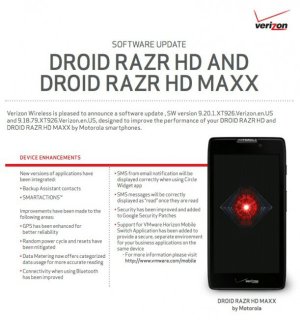

Per the updated release notes, there are two builds. I received the 9.18.79 build on my RAZR Maxx HD.

Received the same build today. I knew it was coming soon so on Thursday I took this last opportunity to unlock the bootloader (though I likely won't put a 3rd party ROM on it anyway) and made sure to download (and activate) Voodoo to protect root.
The update applied successfully despite the unlocked bootloader. I had not yet put an alternate recovery on the phone. Root was successfully restored with Voodoo.
As far as I can tell, the bootloader remains unlocked - or at least continues to show the "unlocked warning" text. Now that the system is updated, I'll consider installing an alternate recovery. I don't want to lose the USB audio-out via my car dock so I likely will stick to the stock ROM (Verizon bloat frozen via Titanium).
