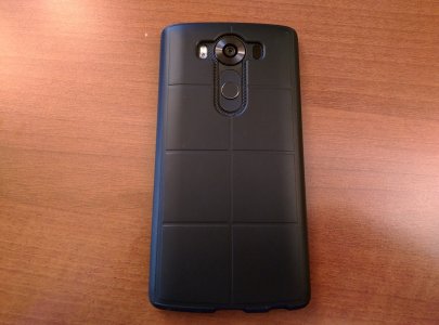

Got the Oblique case today. Fits well and does not interfere with fingerprint reader. I may end up running the phone naked but the case is fine.
Can you post some real pictures showing this case with the phone in it?
This looks like a great case for the V10.
