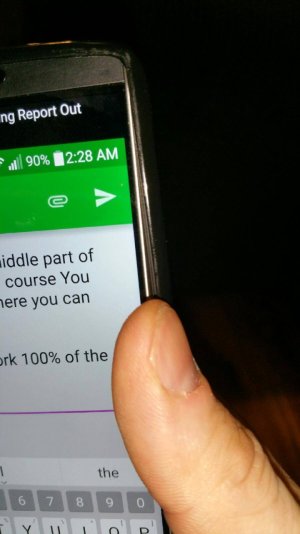

I have 2 workarounds that work 100% of the time for people with flexible cases. I have a flexible TPU case.
1. Peel the case back slightly so that your thumb can touch it while using the fingerprint reader.
2. Cut a section off the edge of your case so that the side metal piece can be touched or cut out a middle section of the side so that the side metal piece can be touched.

The amount of section I'm suggesting to cut off from the case in solution 2 is so small it would not make a difference if dropped. I'm talking milimeters from the front edge. Just enough for your skin to touch. The case wraps around to the front and cutting off just a slight amount from the front wouldn't make a difference. Also the section I'm talking about cutting from the middle wouldn't make a difference either as there would be casing around the section that would absorb impact first when dropped. You're counterpoint doesn't hold water. 👎
The solutions I offered above work!
