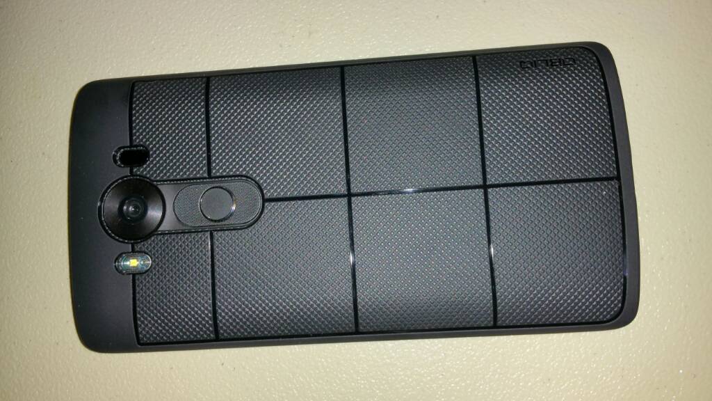

You're not the only one, VDub. I have a simple hard/shell case with a LARGE opening for the volume/finger print reader. I've also got the same Obliq case. The scanner works like crap with either case on.. and I'm not putting my finger down in any different angle that I would with the phone naked. With the phone naked, I get the scan/unlock working 98% of the time. Something definitely has to be different from V10 to V10 for us all to have such wide differences in how cases work with the scanner.
On a side note, concerning the Obliq case. Mine isn't a perfect tight fit. I see a gap on the left side where I can actually see the steel rail. I contacted Obliq via the Amazon (contact seller) link. As someone posted in another thread, Obliq replied back that they know of the issue, and that a new batch has been remanufactured and being released today (11/17). They are sending me one.
I don't think it's the cases, or the angle of the finger touching the sensor. I believe it's a ground issue. If your hand isn't touching the metal on the sides of the phone, it isn't going to work. Some really thin cases may get enough ground to make the finger print sensor work, just like one previous poster said, if he squeezes his phone with the case on, it works.
