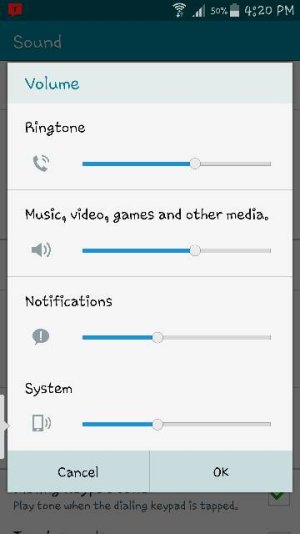

Yes its only the main speakers. I posted a pic of my volume settings. How could i fix this?

The speaker might be blown. Can you compare with someone else with a Note 4? Or bring it in to your wireless store and compare it there.
