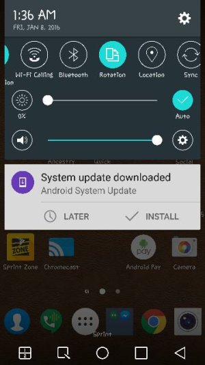

Got it!!
Got my update OTA and installed last night. So far so good. No issues to report so far. Will update in a few days. Located in Seattle.
My daughter and I both received it last night around 10 pm. So far so good.

Got 6.0 notification last night. Didn't do anything to phone to prep for the install. I was demon pressing the update software and nothing. But last night a ran my phone down til it shut off. I have a spare battery and put it in. When it booted up it said update available. I noticed my phone ran pretty hot during the download and seemed it was taking a while. I placed the phone in front of a fan to keep it cool and it seemed to speed up. Maybe it was just me but but during the optimizing apps screen was going very very slow. When i tried cooling it down it sped up and finished pretty fast. So far it just seems snappier. Little to no lag at all. Haven't messed with any "new" features. I'm just going to try and use it as normal to see if battery gets worse. I normally don't use or play with new features after an update until a few days after just to see if battery is affected and response. After that....a kill it with turning on all the "new" options.
