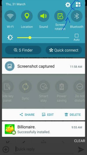

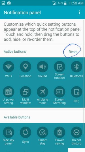

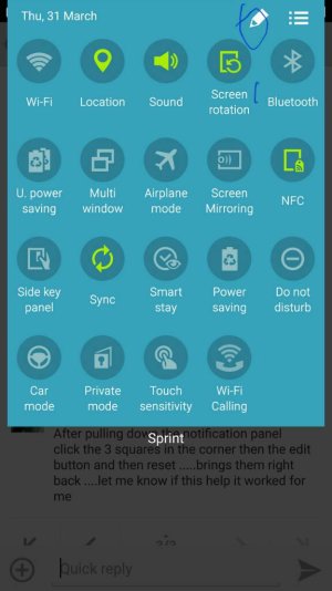

After pulling down the notification panel click the 3 squares in the corner then the edit button and then reset .....brings them right back ....let me know if this help it worked for me.
Here
