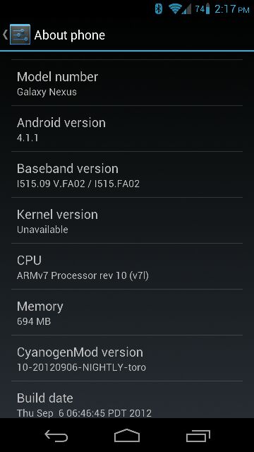

You're looking at it wrong. It is not related to 4.1, it is the radios. 4.1 has the FF02 radios. FF02 does not fix it. Only FA02 fixes it.
http://img.tapatalk.com/d/12/09/12/6uvasa4a.jpg
That's my experience anyway. It's easy to test. I have zips of both I can install back and forth in CWM recovery. Sorry, but you have to be rooted with a custom recovery to do this.
Nah, you just need to be unlocked. I have stock recovery, no root and FA02 Radios. You can boot into a custom recovery without installing it
