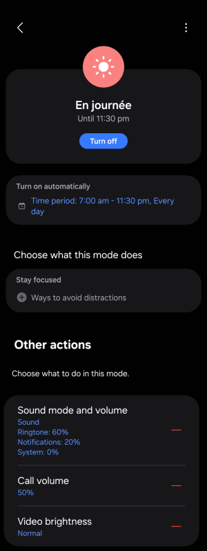

J'ai également configuré un mode dans « Modes et Routines » (voir capture d'écran), mais il n'est pas respecté, que ce soit pour le volume des appels ou la sonnerie. Lorsque je reçois un appel, il n'y a pas de sonnerie, seulement des vibrations et l'écran s'allume.

I also set up a mode in "Modes and Routines" (see screenshot), but it's not respected, whether it's for call volume or ringtone. When I get a call, there's no ringing, only vibrations and the screen lights up.

So how can I answer a call normally, without this option, with the call volume I configured in "Fashion and routine"?

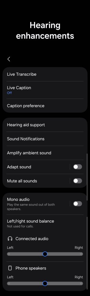

Is it possible that you have enabled an Accessibility feature for the hearing impaired that is increasing the volume when you answer? I do not see one specific to this, but I am not familiar with every Accessibility setting so, just check that they are all off or the ones you do not want are off.

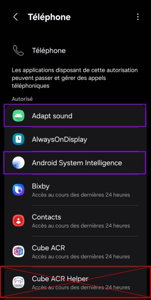

That's it!!!
I found the responsible app!
Indeed, by setting all the apps to "Do not allow" and then changing them back to "Allow" one by one (no restart required between each authorization!) and testing a call each time, I finally discovered that it was the "Cube ACR Helper v1.0.17-sgs" app. I don't yet know if the "Cube ACR v2.4.266" app linked to it will work properly; I'll see in practice, because it doesn't increase the call volume to maximum. So, I didn't need to do what "VidJunky" suggested, but thanks for this very detailed message!
However, I couldn't give permission again to the "Adapt sound" and "Android System intelligence" apps because they no longer appear in the line of unauthorized apps. (See screenshot).
Does this matter?

That's it!!!
Does this matter?
Le problème vient donc de votre application d'enregistrement d'appels, ou plutôt de son « assistant ».
En consultant les informations de l'application Cube dans le Galaxy Store, vous avez besoin de l'« assistant » pour contourner la politique de Google visant à empêcher les applications d'enregistrement d'appels d'accéder au service d'accessibilité, sans quoi l'application ne fonctionnera pas. Vous devez donc soit accepter le problème de volume, soit abandonner Cube.
So the issue is with your call recorder app, or rather its "helper".
Going through the Cube app info in the Galaxy Store, you need the "helper" to circumvent Google's developer policy to restrict call recording apps from accessing the accessibility service otherwise it won't work. It follows you either have to put up with the volume issue or ditch Cube.
Does this matter?
