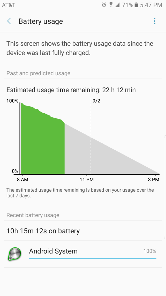

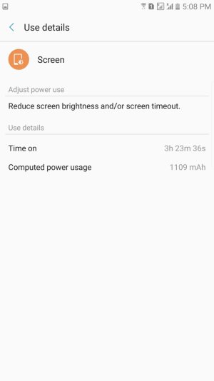

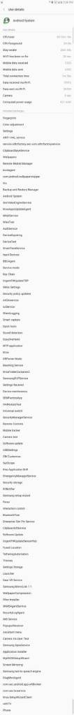

Screenshot_20160901-145128.pngScreenshot_20160901-145139.pngScreenshot_20160901-145146.png
This is what i see
That's a totally different menu and setting so now I'm not sure why I was told that all the Battery settings were the same. So what about that App Power monitor option? It sounds similar to what I'm used to with my previous S6 edge and Note 5 and actual S7 edge, have you tried that to see the options it gives and what it does?
If you go to Battery usage at the top, does it has more options in the menu at the top right?
For the app power monitor, you just select the apps you want to put to sleep until you use them..
Well, then it's kind of similar, maybe that's why you can't see the one I'm saying, maybe it was replaced by this new one. But seeing that it's similar I'd activate and use that.
