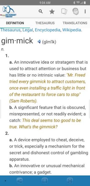

I agree. When I call a feature a gimmick, it's usually because it only works part of the time, or it's buggy. That's not the case with the gestures, it works good.
Being a gimmick has nothing to do with reliability of function. It has to do with adding a feature that is just new or different (intended to get attention), but doesn't really add anything to the user experience. So if somebody feels gestures are no better than the buttons (or worse), then it would make sense to describe it as a gimmick. Now, of course, if you content it does improve usability, then it would not be a gimmick.
