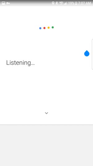

There is a blue tear drop on my s7 screen wont go away
Apr 19, 2017
5
So I had this blue teardrop appear randomly on my s7 edge screen, about halfway down the screen on the right edge, about 1\2 inch in. Teardrop is about a ¹\⁴inch across. No matter what app I open or what page I'm on, the blue drop is still there . Anybody ever seen this?

Welcome to Android Central! What happens if you tap it or press and hold it? I see a little tab to the right of it, so it looks like you can expand something -- try dragging that dot to the left.
The tab ur seeing to the side of the droplet is the S7 edge menu. Nothing happens when I click it, can't drag it either. If I rotate my screen however it does move closer to the middle. Other than that it won't move or do anything.

Seems like a glitch. That icon is the keyboard text cursor. You probably find that you have selected a text box in a certain app and it isn't clearing when you close the app. Or that app could be drawing over the top of other apps. Does it go away after you clear your recents? If you open your keyboard and close​ it again, is it gone?
Agree with beagle82. That icon shows up (although it usually is tilted a bit). If this was happening to me I would wipe the cache partition to see if that helps. If that doesn't help I would temporarily select another keyboard then reboot my phone. Then I would select my preferred keyboard and reboot again.

I would have thought that the GPS icon would point the opposite way (i.e., the round part at the top and the point at the bottom, like the Google Maps location icon).
I've had this. It happens when you use a non standard (eg emoji) keyboard in a messenger app with a floating notification - the Facebook Messenger App in my case.
If you use that keyboard having accessed the message group from the floating notification, and then close down the floating notification, you sometimes get a little blue teardrop! To fix it just reopen the App from its standard icon on the phone's homescreen and you should find it disappears!
That's exactly what it is. I noticed it after exiting my Facebook messenger app. And yes closing out your recent apps it does go away
This is exactly right. I googled what was wrong as this thread came up. Follwed these inductions Abe closed all recent apps. When I closed my Facebook messenger app it went away.
Do you Facebook messenger? It's been happening to me because it closes the chat bubble when I'm editing text and it stays, only fix is a reboot untill Facebook can fix it
Go to settings > Apps > select the menu option then "Reset App Preferences" that will get rid of it on an S7
