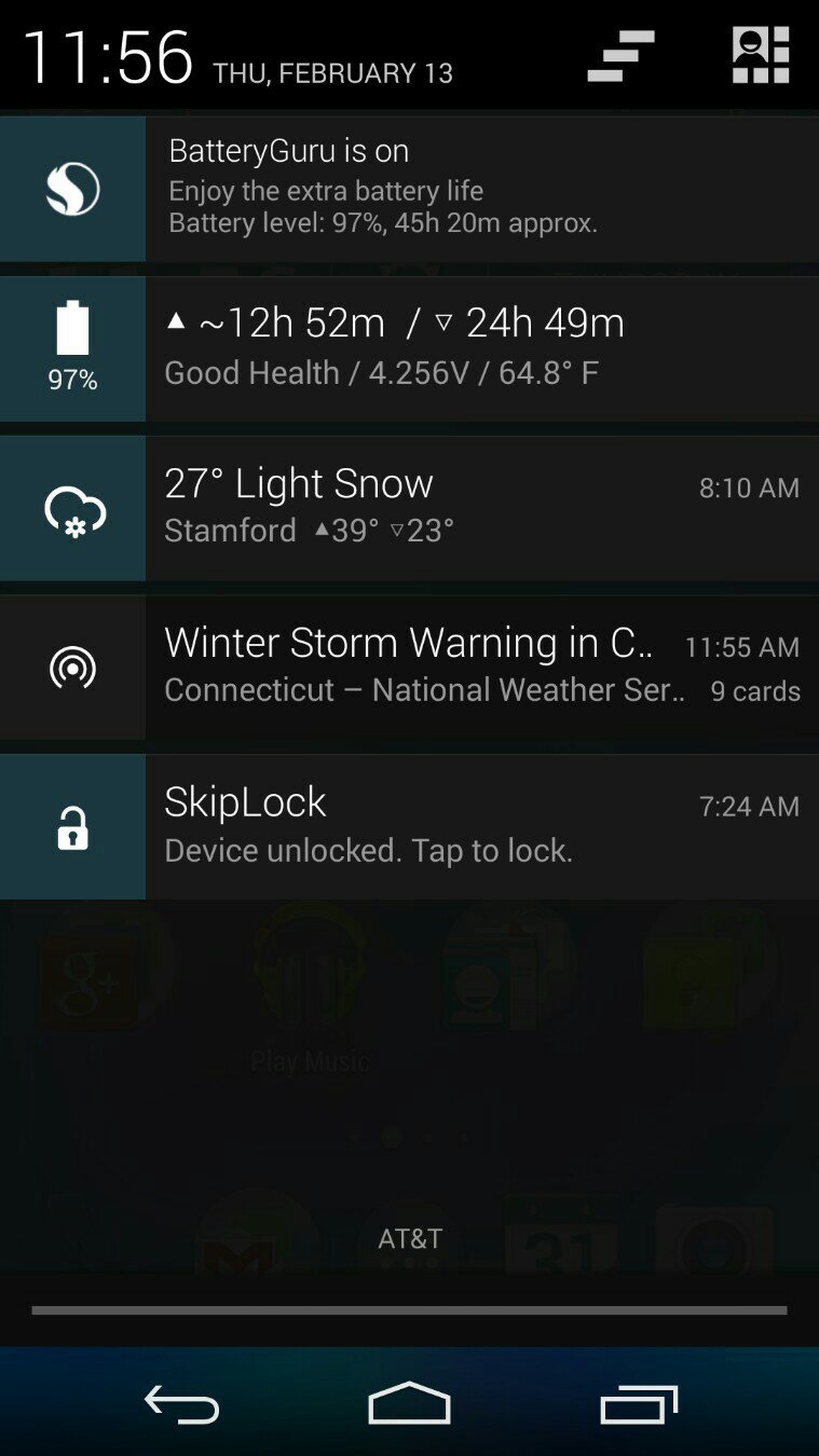

I have two of these chargers and while my phone gets warm, it's not scary hot. In fact, my wife uses it overnight on her nexus 4 and it's cold to the touch next morning. My Nexus 5 and her 4 both have cruzerlite tpu cases on too. So, maybe a bad batch? I got mine in January after the crazy sale made their website go bananas. A green one and black one and both are great.
Nexus 7 Grouper
SlimROM
This is my battery after an hour on the charger. Look at the temp. In the mid 60s. Barely warm. And this is with a cruzerlite spiforce case on.
