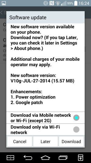

I have just received an OTA update so will test if this fixes anything with charging later on.
Sent from my LG-D855 using AC Forums mobile app
Just checked for an update, lo and behold there is one. Hopefully this will sort out the wireless charging issues.
Thanks for the heads up!

That update makes no difference to the wireless charge issues, same old ****!

What update? Can you check it out at the about section? I have the v10g right now - got it a few weeks ago.
