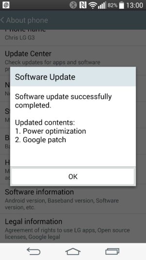

I have just received an OTA update so will test if this fixes anything with charging later on.
Sent from my LG-D855 using AC Forums mobile app
