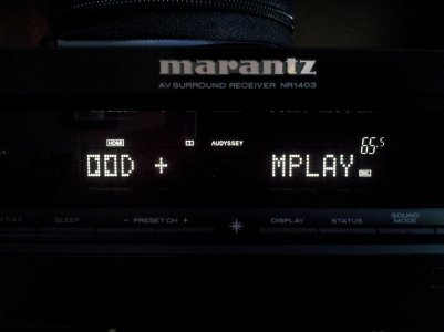

Well in my case my AVR detects it a such. On the Display it is showing DD+, instead of Dolby D as it does from my HTPC. I have never seen DD+ from any other method. I was actually surprised to find it supported, but there are allot of things my AVR does that nothing else I have supports. I have included some pics of the display on my AVR. Of course this can be different for every AVR. The top image is the Chromecast streaming "Captain America, while the bottom is from my HTPC playing TV
Actually I just thought of a new test case I need to try. I need to configure Netflix through my HTPC and see how it comes comes out. I am curious on if it will change to DD+ or stick with Dolby Digital 5.1 that the HTPC normally puts out. Windows Media Player, which is what all Microsoft's stuff is based off, has it's own Dolby Settings and can decode DD+. So the X-Box or any MS based product should work, and at the very least down convert down to Dolby Digital 5.1. That actually explains how the OP could get successful Multi-channel from his x-box and not the CC.

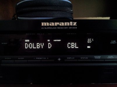

Okay, so this got me thinking what situations might cause the CC to do stereo instead of the DD+ surround track. I recently realized that my AVR a MARANTZ NR-1403 apparently does some sort of pass-through. Basically I can have the AVR off but it will still pass the stream to the TV, and it works great. I have watched a few shows this way since I got my CC. But I am very aware that my TV doesn't support DD+. So here are a few tests I ran
1. Start "The hunger games" with AVR off and confirmed that Netflix would stream fine but only provide stereo.
This was expected since my TV doesn't do anything but stereo and is old.​
2. I then turned on the AVR so that it could take over with decoding and provide audio out. I still only got stereo audio.
I really wasn't sure what to expect. but I kind of expected this.​
3. I stopped the move and restarted it. Still stereo audio only
This actually surprised me a bit. I would of expected a new stream to trigger the device a discovery of sort and get the 5.1 stream​
4. Stopped the movie, disconnected from the Chromecast, made sure Netflix was shut down on my Nexus 10, restarted Netflix, connected to the CC and started streaming again. Still only stereo audio
This was quite puzzling because everything was restarted except for the CC. The only thing of note is that the CC still had the netflix display on the TV.​
5. Open up Play Music and connected to the CC and streamed a few songs. This at least got the CC to stop whatever netflix had running. Once a song played I clicked on the cast icon in Play Music and selected "Disconnect." Now the CC was back to the "Ready to Cast" screen. I opened up Netflix set it to cast to my CC and selected Hunger games and ta da, back to DD+.
Honestly this is just simply what I hopped would happen.​
I repeated this a few times in slightly different manors and all of the results presented in the same manor
So clearly the CC can be tripped up putting out DD+ if something triggers stereo audio first while the Netflix piece is up. By chance do you have that pass-through functionality or something else going on. Either way next time that happens can you try casting from Play music for a few moments then disconnect and switch back. It seems to me that something in the Netflix piece on the CC may be the root of all this. Casting Netflix clearly triggers some app on the CC to load because the screen flashes a Netflix display on the TV and then changes to something else until you start streaming content.It also never went away until I would trigger another app to cast. Not even when disconnecting. So that could easily create a situation where it just keeps it hung on stereo for a long time with no reason.

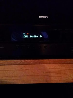

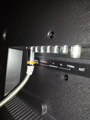

OK, so I'm having the same issue as everyone else. I have my Chromecast into my TV which does coax DD out to my Onkyo HT-R570. My Onkyo receiver is a little older and I think I remember that it won't decode Dolby through HDMI. With nothing casting (just the CC landscapes splash screen) my receiver says it sees Dolby D. As soon as I play Netflix or Plex, it immediately disappears and switches to virtual surround. This means it has to be getting a DD signal at some point right? I've played with all kinds of settings both on the TV and the receiver. Under the audio settings in Netflix it only shows stereo. With the CC plugged directly into the AVR, it never shows DD, even at the CC splash screen.
*****Disregard******
Just noticed that the receiver starts with the DD displaying from the TV even with the CC not plugged in :-/

Your AVR has to support dolby Digital +. If it doesn't your best is going to be stereo or multi-channel LPCM. I have never seen the CC do plain old Dolby digital.
If your reciever can't do DD through HDMI that is a bad sign.
One thing that might save you is if the tv can decode the Dolby Digital + stream. That is generally on smart TV's though. If it can it can down covert to DD for your reciever.
