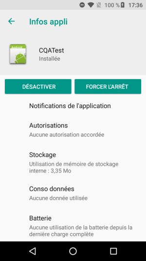

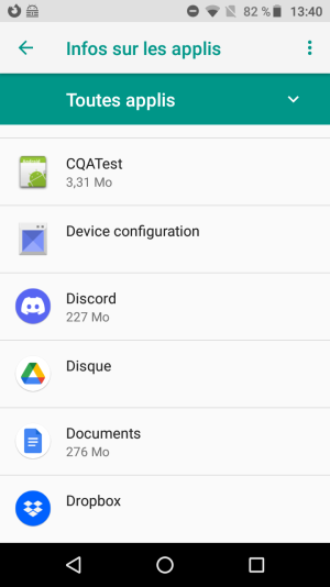

Thanks a lot for your very detailed procedure. As you can see on the attached screenshot the name for my offending application is CQATest.

Thanks a lot for your detailed answer. As you see on the attached Screenshots the offending app name is CQATest. Using ADB "pm list packages" do not show such application .
Any more help ?
Serge
