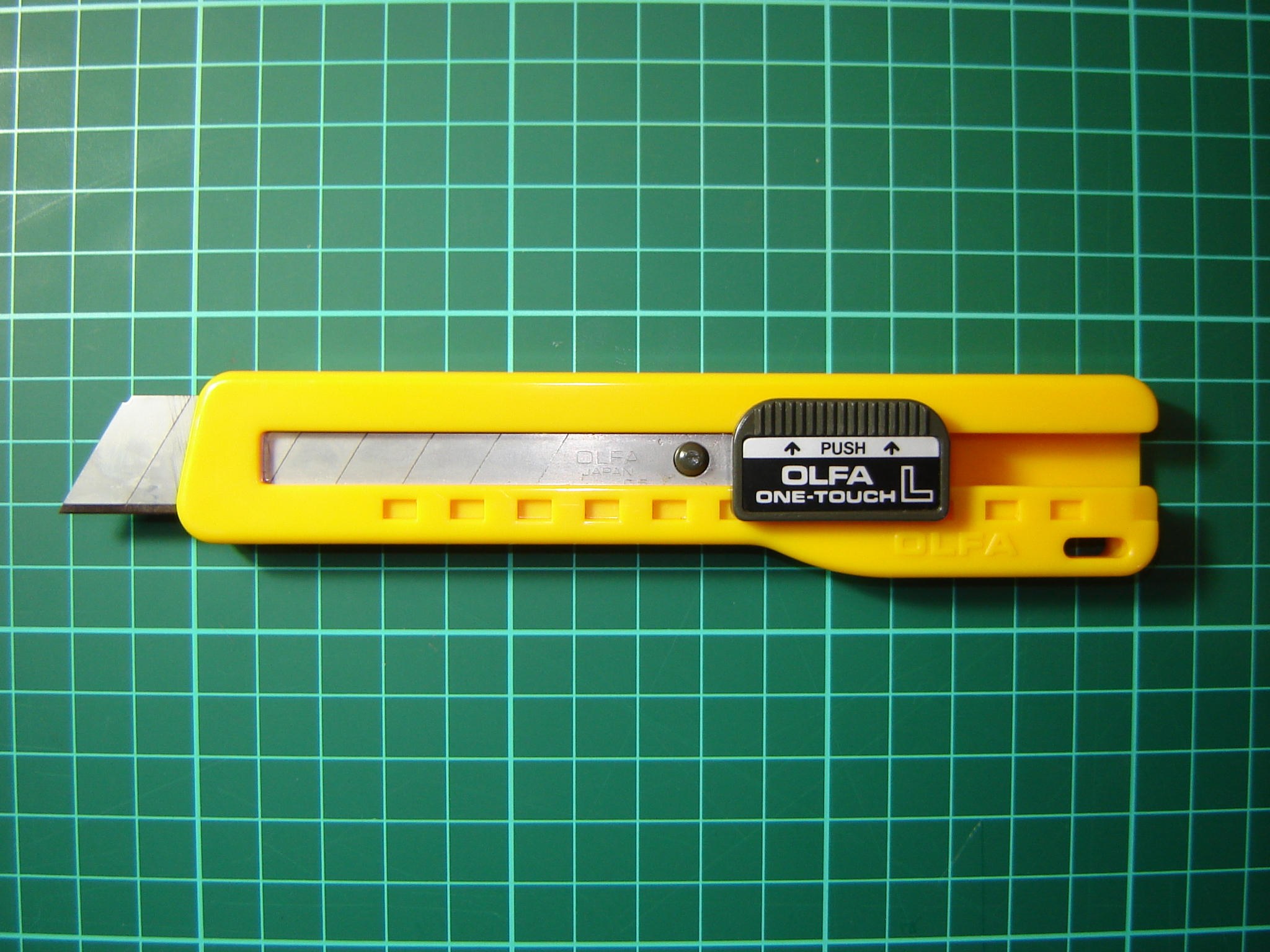

only I did not use a wooden toothpick cause I didn't have one and wanted to fix this immediately
I used a metalic Olfa cutter
instead, since it is metallic I will not recommend this, but I got lucky and my problems went away thanks to you! :)
