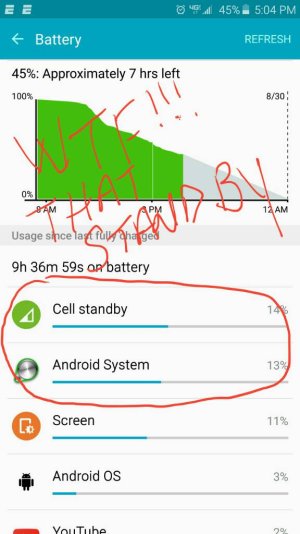

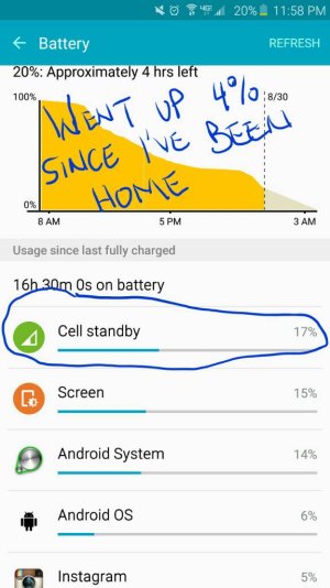

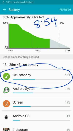

Using Wi-Fi causes Cell Standby bug (Verizon)
The issue is in fact related to WiFi and LTE being on together. When I turn my WiFi off my battery improves by almost 25%!!! That's ridiculous.

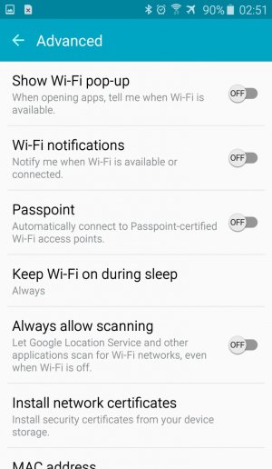

Another issue. When I select to have WiFi sleep when the screen so off IT DOESN'T WORK. I use GSM battery and shows WiFi and cell at the time connected despite having checked that option. Very aggravating

I turned the setting to turn wifi off when the screen is off except for when charging and the cell standby has been 100% gone.
I still need to test whether it not the phone will use mobile data when I streaming music with the screen off or not though... That could be a deal breaker.
Sent from my SM-N920V using Tapatalk
It's back at the top of my list even with the fact that I only have wifi set to stay on when the screen is off when it's plugged in....! In other words wifi turns off when I turn the screen off unless it's plugged in.

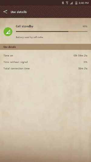

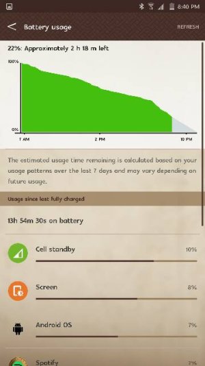

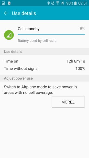

I hope we can resurrect this or someone can link to another page where a solution has been found...I recently purchased a Verizon S6 and noticed immediately that the battery life was nothing compared to my S5. I realized that it was showing a large portion of battery used by 'Cell Standby' despite the fact that this phone had not been activated and had no SIM in it. I ran the VZW software repair assistant to repair any file corruptions, but the issue remains. The 'Cell Standby' info says to put the phone in Airplane Mode to save power. Well, I still don't have a SIM for this phone yet...so I left the phone in Airplane Mode the past few days. Still, 10-20% of my battery usage went to 'Cell Standby'. Today, I took the phone to work with me, where it sat idle (with Wi-Fi on but not connected and location set to 'GPS only'), and it only discharged from 2% (from 100 to 98%) over the course of about 10 hours. Once I got home and connected it to Wi-Fi it quickly drained down to 90% with very little use (I was using my computer, not the phone). The phone is roughly 4 feet away from my Wireless N router. And it continues to drain while the phone sits here idly.

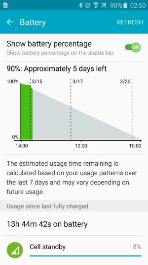

So in essence, I think I've isolated it to an issue that only happens while my phone is actually connected to Wi-Fi, regardless of whether or not Wi-Fi is enabled. Here are screenshots of my battery settings (the ONLY battery usage is listed as 'Cell Standby' -- Screen is not even here).
This phone is using software version G920VVRU4BOK7.
If I understand correctly, the Cell Radio used 8% in 12 + hours. Not sure if I'm following the problem. WiFi radio will also consume battery, and if the WiFi is actually connected to a WiFi network; I'd expect there to be some drain as the WiFi radio is actually working (thus using battery) since apps and services (like Google Play, Photos - as examples) can sync up or backup data, which in turn uses more battery.
The battery drain did not occur over the course of the 13 hours, it occurred over the course of the 3 hours after I got home and connected it to wifi. There is not a lot going on in the background -- I wasn't receiving emails, backing up photos, etc. Typically when those activities are happening they will be listed separately in the battery usage section. So my point is that it appears that simply being connected to WiFi for that 3 hour period drained roughly 6-8% of the battery. That is unusual for any device. That is why I'm concerned.

Taking the 8% value, looks like that's approximately 2.6% per hour (8% / 3hrs). WiFi does need power to operate. It would be interesting to see a chart for the Note 4 on Lollipop, Note 5 on Lollipop, and Note 5 on Marshmallow - all with same apps, same configuration, same usage pattern, and connected to the same WiFi network under the same network conditions - and see what the WiFi chip battery usage rates are. That same methodology could then be extended to other recent/current Samsung phones assuming that they have the same WiFi chip and software with which to make an equal comparison.
Yeah, 2.6% per hour seems excessive simply for staying connected to Wi-Fi, especially because my other devices like Galaxy S5, iPhone 5S, iPod Touch, and iPad can sit around connected to Wi-Fi only for weeks straight without losing a full charge. After a couple more days of testing, I think the issue may be more related to battery calibration because the device is doing much better now and appears to be draining at a rate closer to 1% or less per hour. This is with Wi-Fi connected, location off completely, and Airplane Mode on. Still seems a bit odd that 'Cell Standby' is draining about 8-10% of battery over a 12 hour period with only Wi-Fi connected, but since I can easily charge my phone every night I'm just happy that it doesn't look like it'll be draining 25% or more :) Thanks for your input, and I'll still be watching this thread and testing my S6 without a SIM and without usage for a few more days in case ya have any more ideas!
