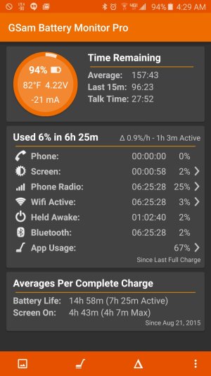

Can you do a screenshot of the battery and the usage under it and also make sure your notification bar is in the screenshot.
I'm actually good today because I'm out at work, but amazingly, it's still #1...! I might have been on wifi for an hour or so this morning?
Here's today:
Here's the other day when I was at home:
Here's today:
//images.tapatalk-cdn.com/15/09/10/4bf2d9e38b6a081e3f5b50c13641ea21.jpg//images.tapatalk-cdn.com/15/09/10/b5b957bc821ffc390f80229b166a3f0d.jpg

OK, hold on.. I needed that picture with WiFi on also.
Alright, I just don't know what is causing that and there are several on Verizon that aren't having that issue. Being on WiFi calling will cause that, it doesn't drain, but makes it a high number, but Verizon doesn't have WiFi calling.
You could try operating in safe mode for a while and see if it pops up high. If it doesn't, then an app is causing it most likely, if it does, then it is something else.

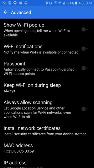

This may have been covered, but I'm personally on Tmobile. When I first got my N5, Cell standby was always on top of my battery drain, no matter how long I had the screen on. I'm someone who had always had the wifi setting set to "always stay on" while my screen is off. I changed that setting to only connect to wifi when my screen is on, and poof, it fixed the problem immediately. Cell standby is always near the bottom. Now I'm getting great battery life, and all is well. Again I'm sorry if this does not pertain to this thread, or if it was covered already. I just wanted to share my success.
Dont have option to do it when screen on. Only options are:
1) Always
2) When connected
3) Never
I'm sorry again... Keep wifi on during sleep (Never) is what I have set. Lol
But thats not a solution as it is going to use data while it is not sleeping...sometimes can be a lot. And also...it will use battery to connect to wifi every time you wake the phone up. And finally battery drain will happen due to cell standby will happen while the phone is awake. I am sure it is better this way than having it always on...but this is not a solution to the problem.
Any idea what "When connected" means? It is when connected to a charger or what?
Yes I believe so. Tmobile litteraly says "When plugged in". Different wording, same setting.
I understand, though I've noticed a huge improvement in battery, and no added data used. I have regular app syncs too. Just my experience.
You're right though, I believe with wifi on LTE is still running too. (Seems like a bug to me) but if you have wifi Off while screen is off then it's just using LTE while screen is off (of course using data for syncing) That's how I understand it, and since it's Verizon and Tmobile, it might be a Samsung N5 issue.
The issue is in fact related to WiFi and LTE being on together. When I turn my WiFi off my battery improves by almost 25%!!! That's ridiculous.
Another issue. When I select to have WiFi sleep when the screen so off IT DOESN'T WORK. I use GSM battery and shows WiFi and cell at the time connected despite having checked that option. Very aggravating
