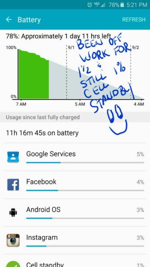

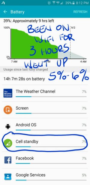

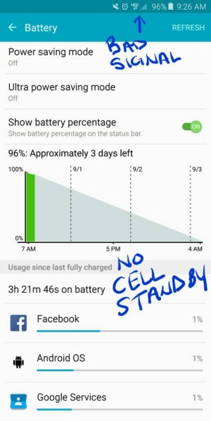

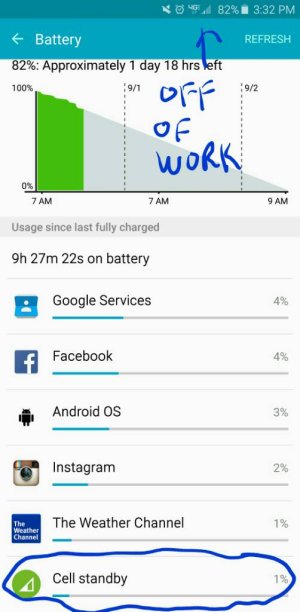

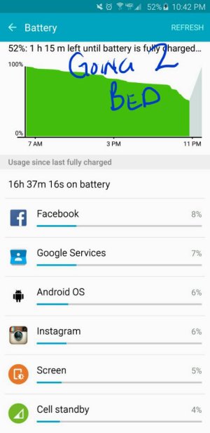

Yes even though I'm getting decent battery life with a high percentage Cell Standby, my issue is that I'm getting worse Cell Standby when connected to WiFi when that shouldn't be the case. Last night I wiped the cache again, rebooted the phone and then turned it off and powered it back on to see if it'll fix something.
People have suggested that poor signal and having advance HD calling (also known as VoLTE) could cause this Cell Standby. I'll post a screenshot that I took throughout my work shift where I had 1 bar of LTE and after my 8 hour shift was over I only had 1% of cell standby. It seems like a lot of people are pushing this Cell Standby issue under a rug when this is a serious problem (Verizon only?) just look throughout the battery thread and you'll see numerous screenshots of Cell Standby up at the top.
Just imagine if you're already having good battery with a high percentage of Standby if Cell Standby was nonexistent or at least under 3% throughout the day
I have tried the S6, S6 edge, G4, and now the N5...all suffer from same Cell standby issues. When I'm about I turn off wifi and my cell standby is controlled. It can't be a coincidence that all three had/had with same problem. My frustration is when people on Verizon tell me they don't suffer from this and like I'm the very few who has this problem. All 4 phones having this problem means to me that it's a major issue but oh well....

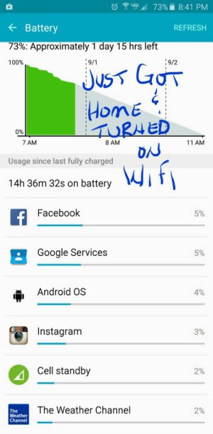

Here was my experience yesterday. A lot better but then again I wasnt on Wi-Fi that long when I got home. I took a screenshot at every break at work

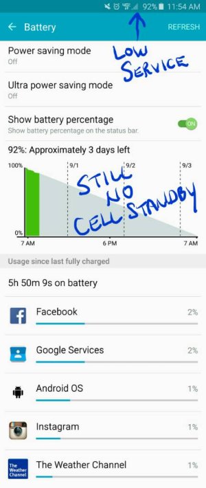

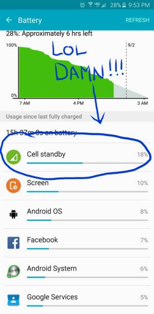

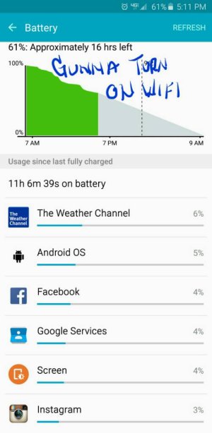

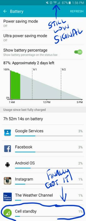

Here's what my battery looks like as of today

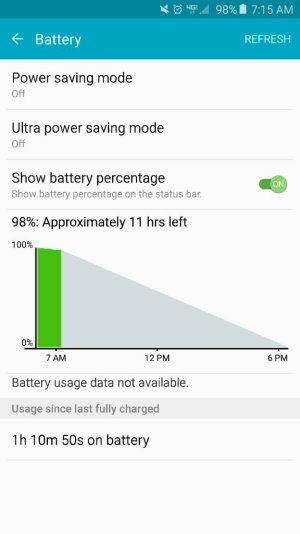

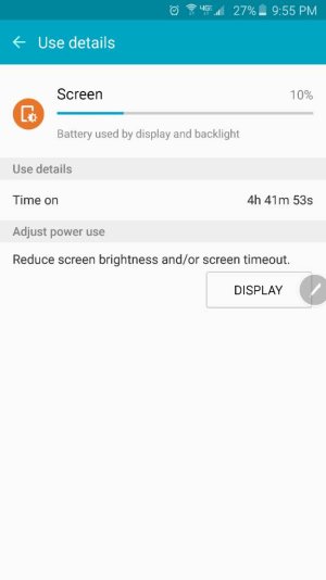

Lol this bug

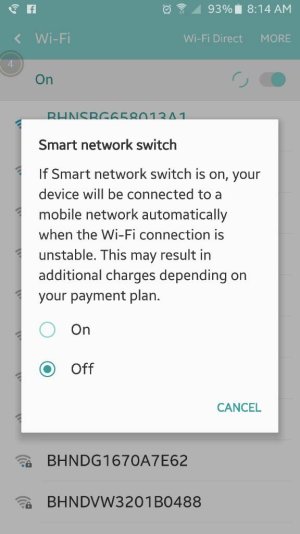

Couple of things.. Those on Verizon, are you using anything like this? This was written for the S5, but it is the same.
http://www.verizon.com/support/knowledge-base-97134/
If not, do you use any WiFi manager?
T-Mobile and other carriers.. Do you have the WiFi manager turned on?
Also does anyone have the built-in Smart Switch turned on, it needs to be off. You gp to WiFi under settings, click More and you will see it listed.
