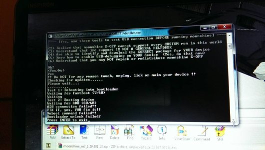

This what I get after running moonshine mate. Usb fastbbot is displayed on my screen.
Sent from my HTC One using Tapatalk
No. I'm not sure how to do it. I've read the description but I don't really get it. This is all quite new to me.
Let me look over it. It should be similar to rumrunner since it is made by the same developer.
Wizzrah, Android Central Ambassador | Sent from my AT&T One XL running Karbon Kat. \(^~^)/
Thanks mate. I'm just looking on xda, see if I can figure it out.
