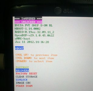

I did not made back up my hboot versrion is 1.14.0002 IMG_20130930_114256.jpg what should i do now?. will flash 4.1 based rom?
Re: **now with pics/proof** root,bootloader unlock,s-off at&t htc one x on 3.18 update!
I did not made back up my hboot versrion is 1.14.0002 View attachment 83713 what should i do now?. will flash 4.1 based rom?
YOU SHOULD ALWAYS MAKE A BACKUP... anyways, flash the latest RUU which you can get here

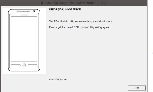

I got an error Installing RUU.exe
now i cannot go to recovery..but still can go to bootloader..what do i do now?.. =(
You have to flash the RUU again, keep trying. Make sure your phone is in fastboot mode.
