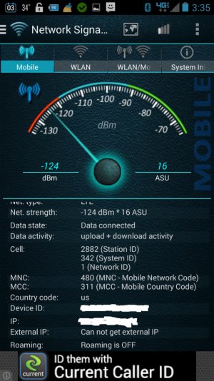

I noticed that very weak 3g signal works better than very weak 4GLTE signal. Also, not all towers are 3g and 4GLTE. If you look at the attached, the LTE signal is substantially better than 3g.

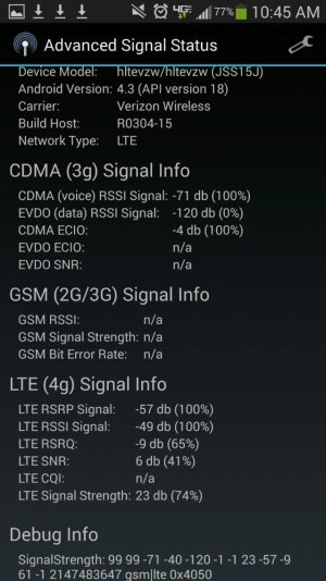

i see, learning something new every or every other day :) so is the lowest lte and 3g signal -120 and the lowest voice signal -110? i used this app https://forums.androidcentral.com/e...s/details?id=de.android.telnet&token=d9QDWTbG
and the lowest signal it shows is -135dbm for lte and -110dbm for voice thats why i thought it was possible to get a working signal at -121-122dbm. The developer needs to update the app but thats why im happy their are forums to learn from. I didnt know until you informed me thanx :)

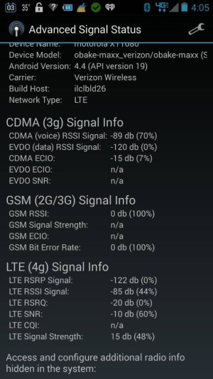

Look I checked when I hit the dead spot again it shows I'm still receiving and sending data

You might want to edit out your sim id. Are you able to browse the Web at this spot?

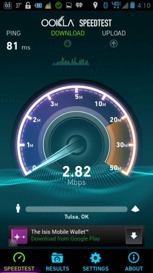

I ran Iheart radio that's the only thing I could think of lol also I did half a speed test to show i was still getting data

Btw, when you are seeing - 124dbm,did the speed test complete? Usually when I see anything around that, the Internet is extremely flaky. In fact, I removed the back cover on my old rezound which has the antenna in the back cover, and saw 123.

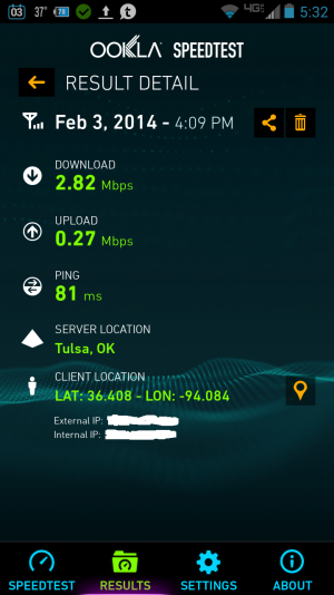

here is with it finished sorry i dont know why i didnt post it instead of the 1 above duh lol
When i took this speed test it was in between -118 & -124 i was moving slowly when it was taken. My father was driving and he didn't want to stop so when the signal dipped to -124 i tried to hurry and take the test. So for more accuracy i will repost when i drive by myself and can stop.
