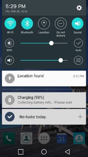

Mostly the same here... The location debacle here too, see screen shot below. As you'll see, location is off, but yet something accessed location. Notice the time in notification area vs. time location was found. I had disable the weather app prior, so thats not it.
