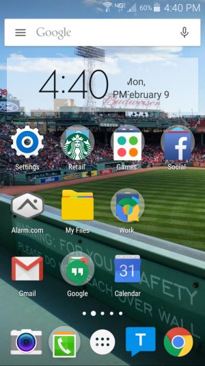

One oddity jumps out at me is with the widgets. Whats with the text not fitting?
