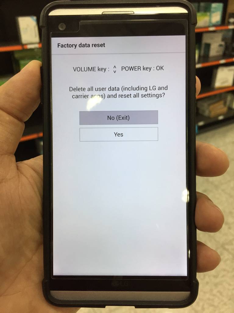

I see no way to clear system cache other than how we all know through system settings. If you know another way let me know because recovery mode on my V20 only takes me though factory reset
If the instructions above aren't working (which match the instructions on XDA) then it's possible your carrier variant has (for some reason utterly beyond me) removed the ability to do it.
My AT&T V20 when I access recovery mode. (see picture)
Also everything I've searched for specific to clearing the system cache on this phone showed the instructions through system settings and storage. So I'd love to know if there is a real difference in the methods and if so how to do it through recovery.
There is a real difference in what the two methods do. But, unfortunately, in the V20's case, it appears that one of those differences is that certain carriers have decided that it's not something they want you doing any more. That's unfortunate. Clearing that cache partition is occasionally useful.
I do know there are certain menus AFTER boot that are restricted if my AT&T SIM is in my Note 4. I very, very much doubt that pulling your SIM will somehow make an option available in the recovery menu - I don't even know how that would work - but ... maybe?
Reverse that. It's more like LG didn't want this ability and it was a carrier that demanded it. In my earlier post when I said the Verizon version was the only one that lets you into the full recovery menu, that statement included the unlocked version as well. Unless something changed through an update, Verizon is still the one and only version of this phone to allow this.

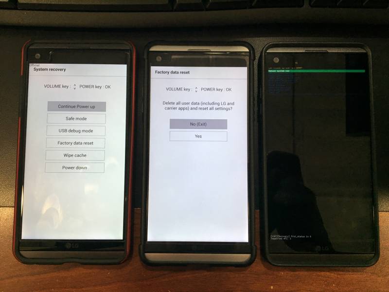

So... On my AT&T V20 (middle) you press and hold volume down then press and hold power, when the LG logo appears, release the power button and press again to reach recovery.
On the Verizon V20 (left) and the Sprint V20 (right) you just press and hold volume down and power and keep holding until it starts recovery mode.
Both Verizon and Sprint let you wipe System Cache from here but the AT&T version doesn't.
Obviously the phone has to be powered off first no matter what carrier it is.
