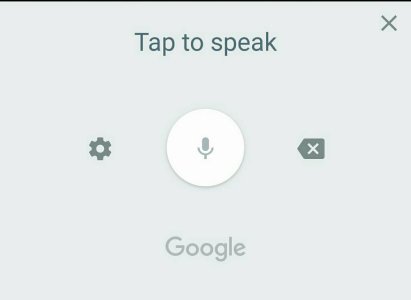

I have TMobile, and have noticed for the past week, when doing voice texting or dictation, Google Voice only picks up a portion of my dictation. I was using Textra, then back to Samsung message, switched from Google keyboard to Samsung native keyboard, but the problem still persist. Interestingly, there are no issues with Google Assistant or "OK Google. Any suggestions?Screenshot_2018-04-19-09-53-10-1.jpg

Yes! I just discovered this yesterday. Go to setting in Google. Google-->Voice-->Voice Match. Turn off Voice Match. See pic. Curious if it also works for you. :)
