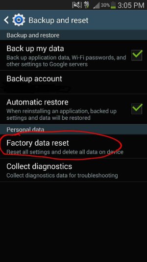

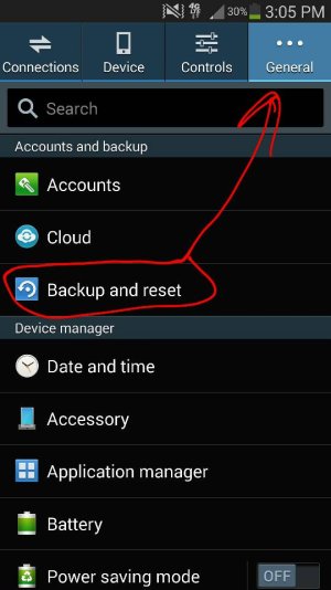

Seems like a lot of work for something that is reported to not correct the issue.
Follow the steps below. :).
Sent from my T-Mobile Note 3 using AC Forums.

Thanks for the info on Factory Restore. I knew how to do that, it is just someone previously mentioned "hard reset" as apposed to calling it a Factory Reset. I thought maybe they were a bit different, but I guess not.
