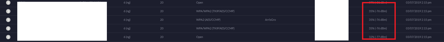

Incorrect --- You can very much so get an app and view the actual -dBm signal of a WiFi connection just like you can do for a cell signal. The only difference is you can go into the phones system settings on most phones to see the -dBm for the cell signal without an app.. It is actually very common for signal to be displayed this way.
For example I use corporate equipment at home for my switch/router/Wireless AP and as you can see (below) it shows the neighbor APs that it has seen and clearly displays the -dBm signal from their AP to mine. That is because -dBm is used to measure cell/wifi signals.
