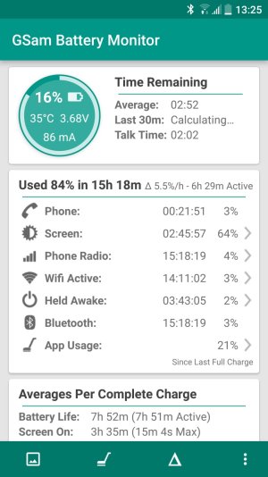

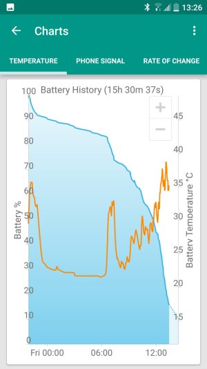

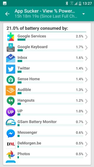

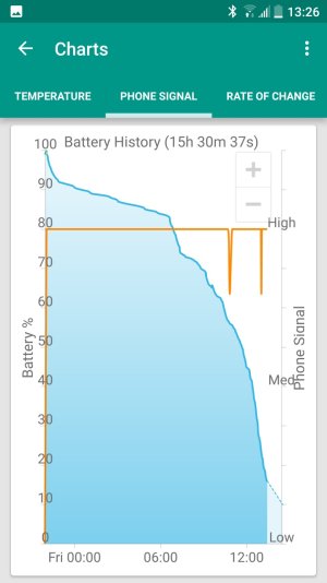

Well, here are my screenshots for the battery doctors :) Charged until 100% and then unplugged and went to bed. Read a little, then went to sleep. Lost 10% overnight. Then went about my day and was at 16% by 1.30PM. Far from two day battery life, huh ;) Not even 16 hours with almost half sleeping...

Well, here are my screenshots for the battery doctors Charged until 100% and then unplugged and went to bed. Read a little, then went to sleep. Lost 10% overnight. Then went about my day and was at 16% by 1.30PM. Far from two day battery life, huh Not even 16 hours with almost half sleeping...
Hm your wifi signal seems really low -- I wonder if that may be a cause. Maybe it is powreing up more to keep that signal going. It looks like your cell signal is okay (what does it show under about phone > status for the signal in -dBm?)
RSRP(dBm):-95 RSRQ(dB):-7
