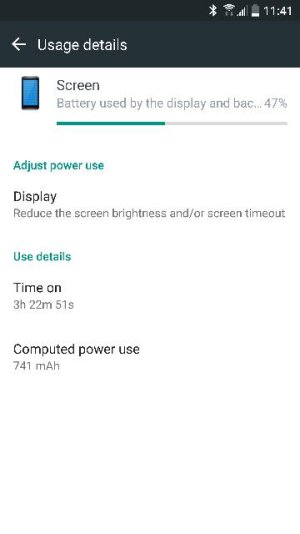

Got a new unit because of screen issues. I did have the feeling the battery was doing somewhat better, finally lol. Curious to see how this new HTC 10 does. So far I'm happy with first day usage drain not being too bad ;)

Already getting better battery performance on this new unit straight out of the box!
