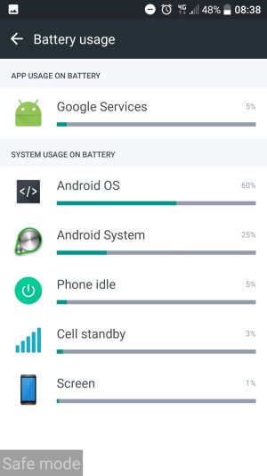

4% battery drain per hour without wifi/nfc/location/only once per hour checking the screen.
in SAFE MODE.
60% going to Android OS
Tried all the uninstalling, factory reset, safe mode. It is not good.
It pretty much happened from one day to the next. Still think it is software somehow. BUT HOW?
update: mine is being replaced under warranty.

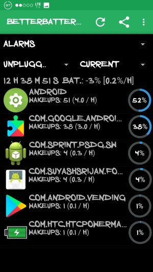

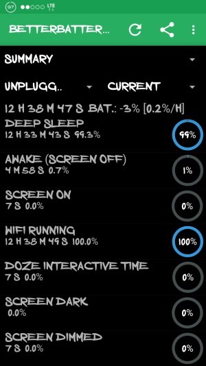

I got my HTC 10 in March 2017, no battery problems after finding what exactly/ literally was killing my battery. Like you, a judicious blend of feature selection and careful app selection, and moderate use, gets my device through 2 days without a charge because my device also sleeps solidly in between usage points.
My pet peeve was my device draining madly overnight. I fixed it with some research.
My 15 month-old HTC 10 sleeps like a baby now. For most, it's not battery failure, it's probably how the device is configured by the user.
