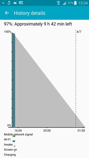

Also, the Note 4 battery meter does have a decent way of monitoring cell signal, albeit not terribly precisely - and it's not terribly obvious to find it. Simply go to "Settings" / "Battery" and when the summary graph comes up, tap on it to go to the detailed graph.
You'll get another view of the graph with stats like "Mobile Network signal" (green = good, yellow = meh, orange = bad, red = nope), Location on, WiFi on, Awake, Screen on, and Charging.
The nice part about that screen is that you can see the signal stats and kinda sorta associate weak signal, screen on, location on, or WiFi on with the current speed of discharge.
There's no way to zoom in or see -dBm for signal at any given time, but it gives a pretty decently solid idea of what is going on for my purposes - no extra apps required.

Horrible screen shot since there's no history on it, but...
