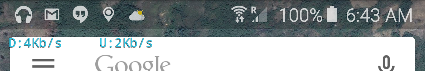

Probably Samsung. Here is what it looks like on my s6. The circle in the middle does blink on and off.
Sent from my Pearly White Verizon Samsung Galaxy S6 Edge

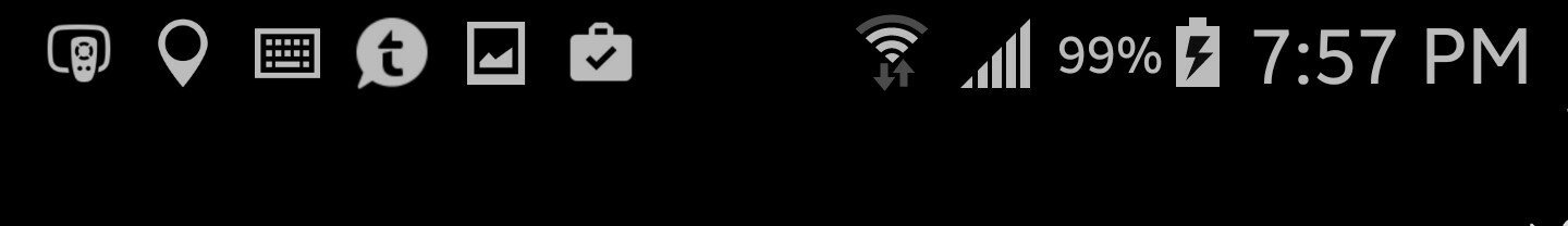

Here is the one from my Note 4 it looks like the OP's to me.
