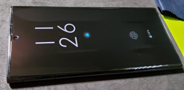

Finally received the Whitestone dome yesterday and installed one this morning. Everything looked perfect until I looked at it under LED lighting. I have a huge shadow on the right side and a strip down the middle. Only noticeable on dark or light screens. Had this same problem with the WSD for the Note 20 ultra. I could just live with it, but it's going to drive me crazy.
Anyone else see anything like this?
Here is a pic under LED lighting.
Finally received the Whitestone dome yesterday and installed one this morning. Everything looked perfect until I looked at it under LED lighting. I have a huge shadow on the left side and a strip down the middle. Only noticeable on dark or light screens. Had this same problem with the WSD for the Note 20 ultra. I could just live with it, but it's going to drive me crazy.

Should I peel this off and try again?
Had this same problem in the past on the Note 20 Ultra and the second one did the same thing.

Guess I'll peel it off and see if round two is any better.

Round 2 = PERFECT !
I honestly believe that work light I was using overhead was curing the glue as it was spreading. This time I did not use that work light and everything looks perfect.
