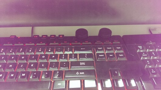

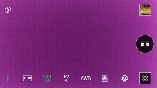

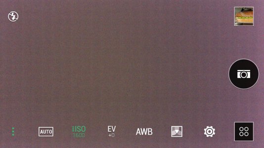

I got it bad on mine. It's only noticeable on low light or dark pics. I use a DSLR camera so it doesn't bother me too much right now.
I covered the lens
Regular pic
Sent from my HTC One using Tapatalk
My camera use to look like yours with purple haze. Only way to fix it is to send it in have them replace camera module. No software update will fix a damaged camera sensor.

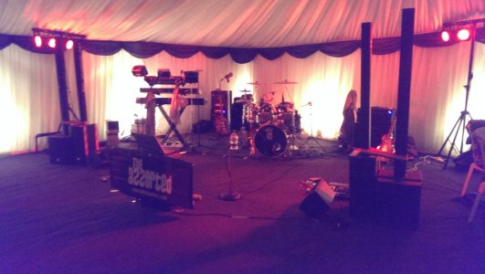

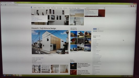

I have very bad purple tint, although it only happens when I take photos at night and of dark objects. Below are 2 photos taken a few seconds apart, under the same lighting condition. As you can see, the tint only appears for dark objects. I've had this problem since the first day, though it doesn't really bother me since I never take photos with my phone.
