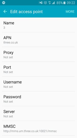

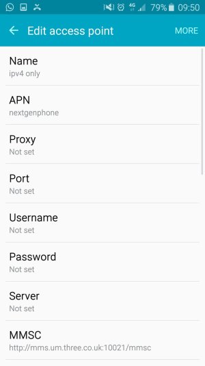

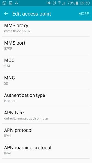

I already tried any possible fix (wiping cache partition, uninstalling all the updates from the play store, deleting all the app data), including your APN settings that, actually, are not different from Three.co.uk (I live in UK).
Please, find attached all my settings (I'm uploading both the APN manually configured and the original by Three). It could be that I'm doing something wrong.
I would really appreciate if someone could help me with this.
Thanks in advance

If you are having Sync issues that is a different problem than getting your notifications delayed. Some EU countries have shamefully implemented tighter restrictions on their networks but Italy is not one that I'm aware of. If your phone was working fine prior, I wouldn't change anything, if you however had issues from the start than I would consider changing your APN but based on what you said it sounds like another issue and not Carrier related. I hate this suggestion b/c this is what everyone says but removed your Google account completely and add it back it, do this over wifi so the sync completes faster than test GCM which in theory times out at 28min before the network timeout on IPv6 or 4 depending on which you use.
