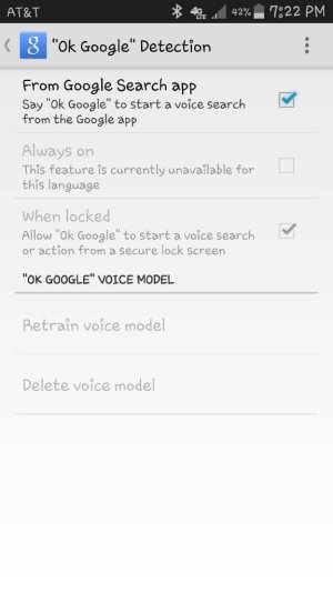

There is definitely something wrong with google now. I had been using it since I got the phone n the last few days it won't work unless I open the app first. In the settings I have it checked for "when locked", but it is blacked out. I can not chage the current setting. It also has the voice model blacked out as well, so you are unable to retrain it if you would need to.
Did you change the language? Where the "Alaways on" selection is it indicates a language issue.
No I did not, but I tried changing it around before posting this n that didn't help either.

If you go into 'Google Settings' -> 'Search & Now' -> 'Voice', you should have 'Languages' at the top. Make sure that's set to a language, like English (US), that Google Now works with. Some languages do not have access to "Ok Google", so you need one that works enabled and set as the default language for the check box to be selectable.

Try resetting the language Under settings-language and input. After the latest update, my language was reset to the first one on the list, and Google does not support that language.
