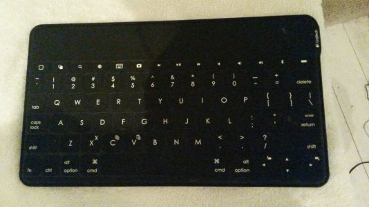

Have tried rebooting, turning wireless off but my Nexus 7 keeps saying there are no nearby bluetooth devices. It is a Logitech keyboard that my Samsung phone recognises but not the Nexus??
Welcome to Android Central! Is there a Connect button on the keyboard that you have to press for other devices to see it?
Does the Nexus 7 detect other Bluetooth devices, like a headset or speakers?
There is only the on/off button, which when on other devices see and sync with it.

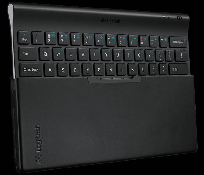

Is this the type keyboard your talking about?
If so, then there is a connect button on the bottom of the keyboard.
