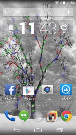

I just got a brand new N5. So far so good but theres a couple of things that are bothering me... mostly the fact that widgets dont seem to self update at ALL!! When I tap on them they still work, but the actual widget stays the same. Anybody know how to resolve this? Im coming from a Note 2. Thank you all in advancedScreenshot (11_56AM, Dec 20, 2013) (2).jpg

I was looking for a specific widget to check the latest date in the Play Store. You said that when you tap on them they still work. What makes you believe they are not auto updating? Are you expecting them to look different on every update?
Widgets are generally "active" in some manner - displaying current weather or temperature, number of waiting emails or texts, etc.
I assume the OP means that said info is not updating as it should.
Remove the widget then add back to the home screen. See if that fixes the problem. If not, check the settings and see if there is an updated interval you can adjust. Something like the clock should automatically update without further changes, which doesn't appear to be happening.
