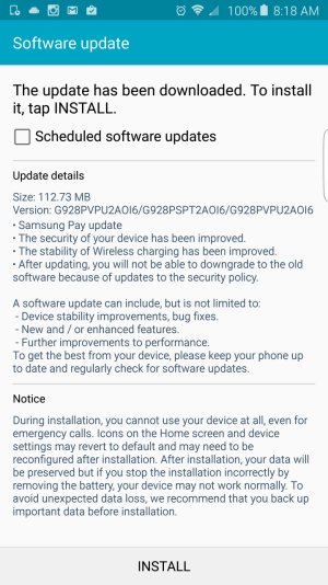

Like others mentioned previously in this thread, my problem was fixed when the Samsung Pay update was pushed out to my phone. I am on Sprint.
Daydream worked, too, but that's not really a fix.
How do I know if I got this update or if I even have this on my phone?
You can go to your settings and select "About device" and see what Software Version you have. The version of my update is in the screenprint. You might also try going to "System Update" and selecting Update Now -- but that didn't work for me. It just got pushed out on its own and one morning about a week ago I was notified of a system update.

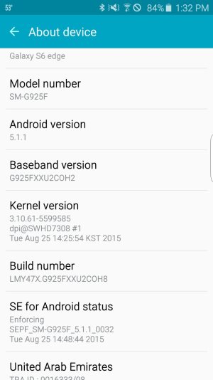

Doesn't look like I have that version. I can't seem to find any info by searching on when I will get it either.
