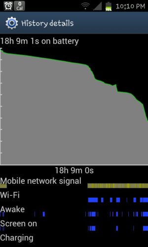

Using new battery for a week now.
Sent from my SPH-D710 using Android Central Forums
