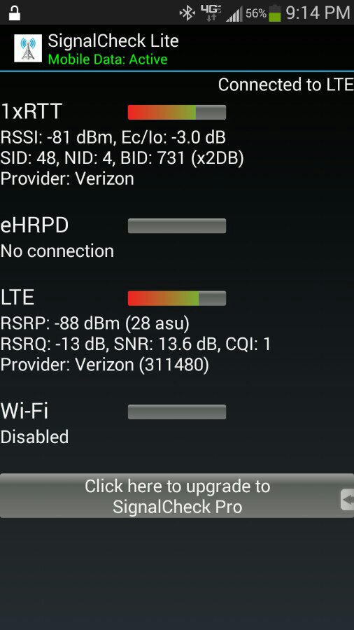

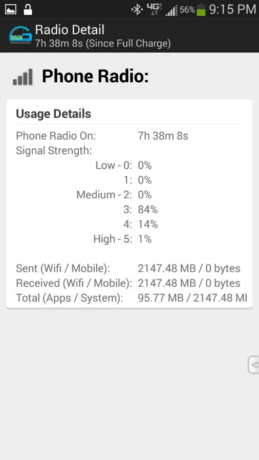

You mentioned your mobile data signal strength (by virtue of having a 4G connection) but didn't say anything about your cellular signal (how many bars). You could try a couple of apps to better quantify that:
GSam Battery Monitor Pro http://market.android.com/details?id=com.gsamlabs.bbm.pro will show you a detailed breakdown of your cellular signal over time
SignalCheck Lite http://market.android.com/details?id=com.blueline.signalchecklite will give you an instantaneous look at the respective signal strengths
