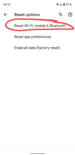

Hold off with the Factory Reset. Instead try doing a Network Settings reset instead. This will reset your WiFi, Mobile data and Bluetooth settings back to factory defaults without the pain of losing all your data and starting over again

It'll look something like this
Ah yes I did try the reset that way yesterday. I just forgot to list it. I remember because I had to re-pair my Bluetooth speaker.
For some reason when I change my network settings they just go back to the faulty one. But even if I could make it stay on GMS it's less than ideal.
